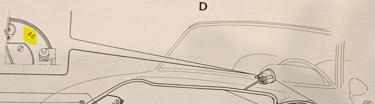

According to FSB No.89 (Fiat Service Bulletin) & the parts cattalog, the Dinoplex was implemented into the Fiat production line on the Spider from Ricambi No.833.
In the parts catalog the split is described in Modifiche C/D 3259, and I have made this notes in my chassis list that you can download from FDF:
C 3259 - Pre mod. Of Dinoplex C: (F1.01: 4147199 ignition Coil - F4.01: 4176396 Engine bay wiring - F5.03: 4156031 Revolution Counter)
D 3259 - Post mod. Of Dinoplex C: (F1.01: 4190859 ignition Coil + 4191282 (AEC101) - F4.01: 4192293 Engine bay wiring - F5.03: 4190132 Revolution Counter (Stamped "AE" on the back side, suspect it means "Accensione Elettronico").
According to FSB No.89 the Dinoplex C was introduced in the production on Spider from Ricambi No.833 in june 1968.
So up to Ricambi No. 832: (Without Dinoplex) Revolution counter: 4156031
And from Ricambi No. 833: (With Dinoplex) Revolution counter: 4190132

Thanks Erik,
I'll check the tachometer for the "AE" marking...
